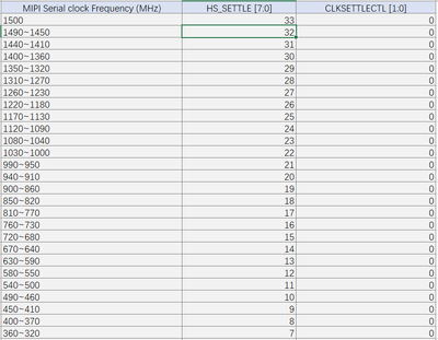

Hi NXP FAEs:
    I encounter problem when I try to make camera which output raw12 data with imx8mp isi platfrom.
    the yocto branch is kirkstone and the kernel tag is: lf-5.15.y
    Please find the patch as attached I worked out for debugging the functions.
    First, I force to use mipi_csis_formats[0] in find_csis_format in imx8-mipi-csi2-sam.c, then csi/gasket register will be configured according to MIPI_CSIS_ISPCFG_FMT_YCBCR422_8BIT. when I run 'v4l2-ctl -d /dev/video2 --set-fmt-video=width=3840,height=2160,pixelformat=BG12 --stream-mmap', both csi interrupts and isi interrupts are tirggered well and there is no error such as ecc/crc reported in csi interrupts. application runs well, isi interrupt reports status 0x60020100 (bit29 shows frames are correctly received and trigger the interrupt, bit 17 reports vsync is ealier than experted (as camera outpus raw12 data and isi expecting yuv data, so frame length is not the same).
    When csi/gasket is configured according to MIPI_CSIS_ISPCFG_FMT_RAW12, application is stuck with below findings:
     1. gasket register report some pixels sent out to ISI (0x32ec007c: 0x0000FB40 and does not increase). it should increase in normal case.
     2. gasket register report no line sent out to ISI (0x32ec0080: 00000000 and does not increase). it should increase in normal case.
     3. csi register report one frame sent out to ISI (0x32e40100: 00000001 and does not increase). it should increase in normal case.
     4. csi register report no dphy error (0x32e40020: 00000000).
     5. csi register report no csi error but data overflow (0x32e40014: 00000010). looks ISI did not handle data from csi and csi data is stuck to sent to ISI.
     6. isi register report no interrupt is triggered (code is added to print something when isi interrupt is triggered, but no infomration printed).
Below is the registers dumped with memtool during runing 'v4l2-ctl -d /dev/video2 --set-fmt-video=width=3840,height=2160,pixelformat=BG12 --stream-mmap &'

$ /unit_tests/memtool 0x32e40000 0x20
register                        yuyv        raw12
csis_version[0]                 03060301    03060301
csis_cmn_ctrl[4]                00004b05    00004b05
csis_clk_ctrl[8]                000f0000    000f0000    bit[4] 0-pixel clock is always alive, 1-pixel clock is alive during the interval of frame
csis_intmsk[10]                 0fffff1f    0fffff1f
csis_intsrc[14]                 00000000    00000010    正常情况为0,偶尔也能读到错误
csis_dphystatus[20]             000000f0    000000f0    bit[7-4]: data lane [3:0] is in stop state
csis_dphyctrl[24]               1300001f    1300001f    bit[23:22] - clksettle. 2'b0x - 110ns to 280ns (v0.87 to v1.00)  bit[31:24]: hssettle
csis_dphybctrl_l[30]            000001f4    000001f4
csis_dphybctrl_h[34]            00000000    00000000

8,620 Views
zhangjunsheng
Hi @joanxie:
     After try, I fixed the hang issue. the cause is the mipi frame resolution camera sent out is (1944 x 1118), but the effective pixel resolution is (1920 x 1080). in mipi frames, there are also embedded data, OB data etc included. so, when I set the camera solution into (1944 x 1118) instead of (1920 x 1080), anything is ok now.
     Actually did not understand the CSI behavior I present in previous updates. but it's not important now and I will treat it as a lessen: when configured resolution is smaller than mipi frame resolution, CSI could be overflowed.
Best regards.
Johnson

Hi @joanxie
   the camera is imx715.
   dts as below
&isi_0 {
	status = "okay";
	cap_device {
		status = "okay";
&mipi_csi_0 {
	status = "okay";
	port@0 {
		mipi_csi0_ep: endpoint {
			remote-endpoint = <&imx715_mipi_0_ep>;
			data-lanes = <4>;
			csis-hs-settle = <19>;
			csis-wclk;
&iomuxc {
	pinctrl_csi0_rst: csi0_rst_grp {
		fsl,pins = <
			MX8MP_IOMUXC_ECSPI1_SCLK__GPIO5_IO06	0x19
&i2c3 {
	imx715_csi1: imx715_mipi@1a {
		compatible = "leopardimage,imx715";
		reg = <0x1a>;
		pinctrl-names = "default";
		pinctrl-0 = <&pinctrl_csi0_rst>;
		reset-gpios = <&gpio5 6 GPIO_ACTIVE_HIGH>;
		status = "okay";
		port {
			imx715_mipi_0_ep: endpoint {
				data-lanes = <1 2 3 4>;
				clock-lanes = <0>;
				remote-endpoint = <&mipi_csi0_ep>;
    dphy status is 0x0 when application is stuck.
    I also compared the csi/gasket registers with imx8mp-evk board during basler camera capturing on imx8mp-evk board, it's the same.
    so are wondering if csi format is configured to raw12, only can cowork with ISP, and can not cowork with ISI?
Best regards.
Johnson

zhangjunsheng
Hi @joanxie
     I shared the dts already and have shared the dumped registers.
     Sorry I don't have the high frequency osc to measure the mipi signals. but from the interrupt triggering message printed, near no ecc/crc error.
     below is the log when set output format as RGB3 (just for debugging, actually it should be BG12). each interrupt bit is printed no more than 5 times to avoid huge message dumped.

the reason I ask clock is that customer needs change hs-settle in the dts according to their own sensor clock if they porting new sensor, if the clock isn't correct, maybe would cause such issue, so I need to check this firstly, if you couldn't measure it, maybe you can try to change the value to see what happen

    Sorry for late reponse as I missed your latest update. From the csi interrupt triggerring information dumped, I did not intend to think the problem is on the mipi csi signal side as no crc or ecc error reported when hang, so I think it may be caused by ISI side, and then try to make camera work in pipe CSI0 - ISP0, but unluckily when using ISP pipe, I face the same issue.
    So I go back to check the issue in ISI pipe.
    Folowing your suggestion, I changed the value of "csis-hs-settle" in dts as each integer from 33 to 7, and also try with/without "csis-wclk" for each value, with below finding:
    1. when "csis-hs-settle" is set in the range from 33 to 9, the csi interrput triggering information dumped is the same, capture application is stuck.
    2. when "csis-hs-settle" is set in the range from 8 to 7, more intrrupt bit 16/17/19 is triggered, capture application is stuck.
    3. switch between with/without "csis-wclk", no affect.
&mipi_csi_0 {
    status = "okay";
    port@0 {
            data-lanes = <4>;
            csis-hs-settle = <33>;
            csis-wclk;
    the camera mipi speed is 891M per lane, which "csis-hs-settle" value is the best?
    For your information I have ever changed the CSI and ISI pixel clock to 1000M (currently is 500M), no help.
