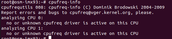

When i run "cpufreq-info" command on yocto , i got the below error.
Below i have add what are the configurations are enbaled in defconfig
CONFIG_CPUSETS=y
CONFIG_CGROUP_CPUACCT=y
CONFIG_ARM_PSCI_CPUIDLE=y
CONFIG_CPU_FREQ=y
CONFIG_CPU_FREQ_STAT=y
CONFIG_CPU_FREQ_DEFAULT_GOV_ONDEMAND=y
CONFIG_CPU_FREQ_GOV_POWERSAVE=y
CONFIG_CPU_FREQ_GOV_USERSPACE=y
CONFIG_CPU_FREQ_GOV_CONSERVATIVE=y
CONFIG_CPU_FREQ_GOV_SCHEDUTIL=y
CONFIG_CPUFREQ_DT=y
CONFIG_ACPI_CPPC_CPUFREQ=m
CONFIG_ARM_SCPI_CPUFREQ=y
CONFIG_ARM_IMX_CPUFREQ_DT=y
CONFIG_ARM_SCMI_CPUFREQ=y
CONFIG_QORIQ_CPUFREQ=y
CONFIG_CPU_THERMAL=y
CONFIG_LEDS_TRIGGER_CPU=y
CONFIG_CORESIGHT_CPU_DEBUG=m
Please suggest me any fixes?

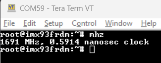

Chavira
Hi @arun_mozhi_thevan!
Thank you for contacting NXP Support!
Try with the command mhz.
The result should be the next:
Best Regards!
Chavira

Chavira
Unfortunately in general in i.MX93 the Cpu frecuency is managed by lpm (Low power Module) and we use the lpm driver in iMX93 and is the reason that we obtain the error using that command.
You can use the mhz command instead.
Best Regards!
Chavira
