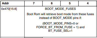

AldoG
I think we have different versions of the Reference Manual, in the image you have shared indeed suggest that just BOOT_MODE_PINS=0x0 it is enough.
In the Reference Manual Rev. 1, the description is different, please see below:
Aldo.

AldoG
I think this is a normal behavior, if you haven't blown BT_FUSE_SEL 0x470[28] that is.
This fuse is checked when performing boot from fuses mode, if this fuse is not blown the device goes to serial downloader when attempting to boot from fuses.
Please check Table 6-2 Boot eFUSE descriptions page 742 of the i.MX8MN reference manual.
Aldo.

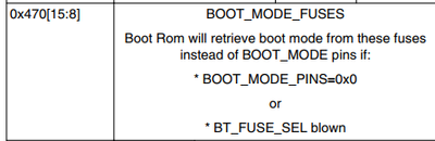

However, when I now go back to BOOT_MODE pin strapping 0b1000, I see that the iMX is booting from eCSPI again, even though BT_FUSE_SEL is blown.
Does that not contradict this section from table 6.30 from the RM?
Because from this table, I thought with BT_FUSE_SEL blown, the external BOOT_MODE pins would be ignored and the fused settings would be used.
This figure is also the reason I thought BOOT_MODE_PINS 0b0000 would be enough to start a fused boot, even without BT_FUSE_SEL blown.

AldoG
Aldo.

wouher
Hi Aldo,
The document I used was Rev 0.
With the description from Rev 1, our system works as expected, thanks.
