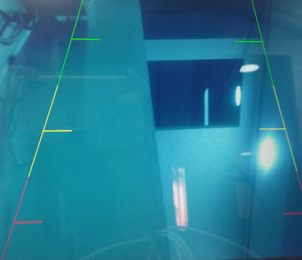

I need some info from your side,
which display connector you are using?
Currently, I am using IMX-LVDS-HDMI ( LVDS to HDMI adaptor card (mini SAS)) and display itself not up in M4.
IMX-LVDS-HDMI-Image
Do I needs to do any configuration in M4 SDK side  (source/vendor/nxp/mcu-sdk-auto/SDK_MEK-MIMX8QM/boards/mekmimx8qm/demo_apps/rear_view_camera) ?

vinothkumars
Senior Contributor IV
Hi Xu hi,
view camera demo is working  (Needs to connect HDMI Monitor at J8 connector of LVDS Port as per schematic (SPF-29420_C2.pdf) instead of J7 Connector.)
