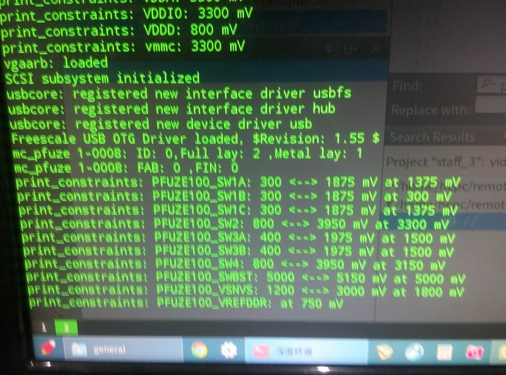

fulinux
Hi igor,
     thank you for your feedback, our hardware has no problem, because kernel in imx_3.0.35_4.1.0 version can register and operate pfuze100, look at this:
do you need any information? pls tell me.
thank you,
