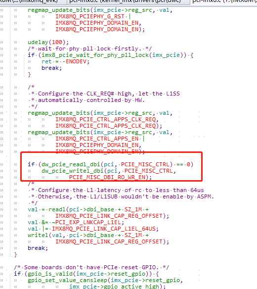

   imx8mq板子android9.0.1.0系统,dts中设置pcie0是okay,clk、en、rst引脚都配置正确,内核就起不来了,具体查看代码是卡在这里,打印日志如下:

[ 3.534706] imx6q-pcie 33800000.pcie: 33800000.pcie supply epdev_on not found, using dummy regulator
[ 3.544138] OF: PCI: host bridge /pcie@0x33800000 ranges:
[ 3.549608] OF: PCI: No bus range found for /pcie@0x33800000, using [bus 00-ff]
[ 3.557107] OF: PCI: IO 0x1ff80000..0x1ff8ffff -> 0x00000000
[ 3.563150] OF: PCI: MEM 0x18000000..0x1fefffff -> 0x18000000
[ 3.569997] imx6q-pcie 33800000.pcie: pcie phy pll is locked.

weidong_sun
Hello Qiang,
     These 2 lines of source code in PCIe driver are used to access  register of PCIe controller. Only when there is an accident in PCIe Controller ,  the problem you mentioned will happen.
     So please check if there is a clock problem!
     In addtion, i.MX8MQ is using external clock by default.  Pay attent to this , please!
