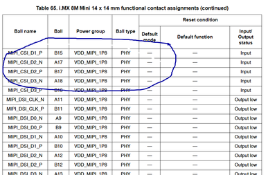

vijay_techsavvy
HI igor,
Thanks for your prompt reply!
1) I have refereed table no 65 in iMX8 mini datasheet, it is mentioned that all the MIPI CSI and DSI signals fall in the power group of 1.8V.
2) previously, we have written a mail to NXP technical support. In reply mail you have mentioned that iMX8 mini MIPI signal voltage level is 1.8V.
Please  clarify on above mentioned points. I am attaching some useful information for reference

igorpadykov
Hi Vijaybhaskar
i.MX8M Mini has 1.2 V MIPI-CSI levels, though power group of 1.8V.
sorry this is not true. In attached answer there are no such words.
Most correct answer can be found in MIPI CSI2, MIPI D-PHY specifications
for example one can look at sect.4.12.12 MIPI D-PHY Timing Parameters
i.MX 6Dual/6Quad Applications Processors for Consumer Products - Data Sheet
igor
