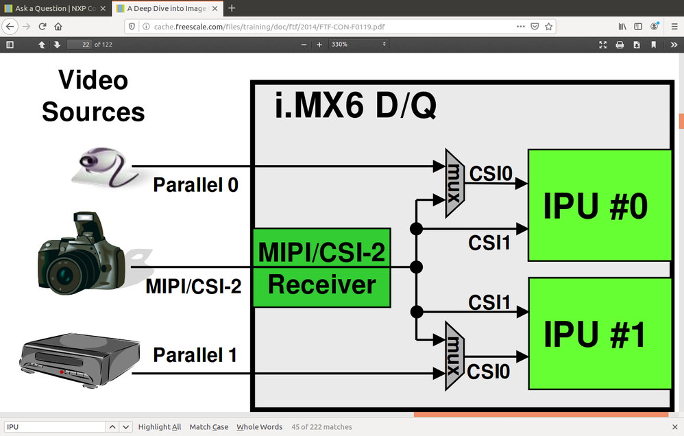

First I want to show the following diagram:
We can see that IMX6Q has two IPUs. Each IPU has two inputs: CSI0 and CSI1. It makes four possible inputs:
1) ipu = 0, csi = 0
2) ipu = 0, csi = 1
3) ipu = 1, csi = 0
4) ipu = 1, csi = 1

Now I want to connect OV5640 through parallel interface - Parallel 0. "i2cdetect" command sees our sensor on i2c bus number 0, address 0x3c. There is no examples for parallel interface configuration, however there are two OV5640 drivers: "ov5640_mipi" and "ov5640". Also looking at above picture I assume that we need to provide ipu = 0, csi = 0 to work with sensor connected to Parallel 0. And finally it appears that i2c bus number 0 is referenced by "&i2c1". So I change device tree description to the following:

So do I understand correctly that we need to set ipu = 0, csi = 0 to capture video from Parallel 0 interface? In this case video capturing will de done by ipu_csi_enc.c + ipu_common.c pair on first IPU's CSI_MEM0 channel.
Also there is such thing as IOMUXC_GPR1 register.
Bit 19 controls whether we accept data on IPU0 CSI0 from MIPI (set bit to 1) or from Parallel 0 (set bit to 0)
Bit 20 controls whether we accept data on IPU1 CSI0 from MIPI (set bit to 1) or from Parallel 1 (set bit to 0)
Probably we need to write this register to select parallel source.
Or do we have to configure IPU in another way?

igorpadykov
Hi Igor
yes CSI is camera parallel interface.
