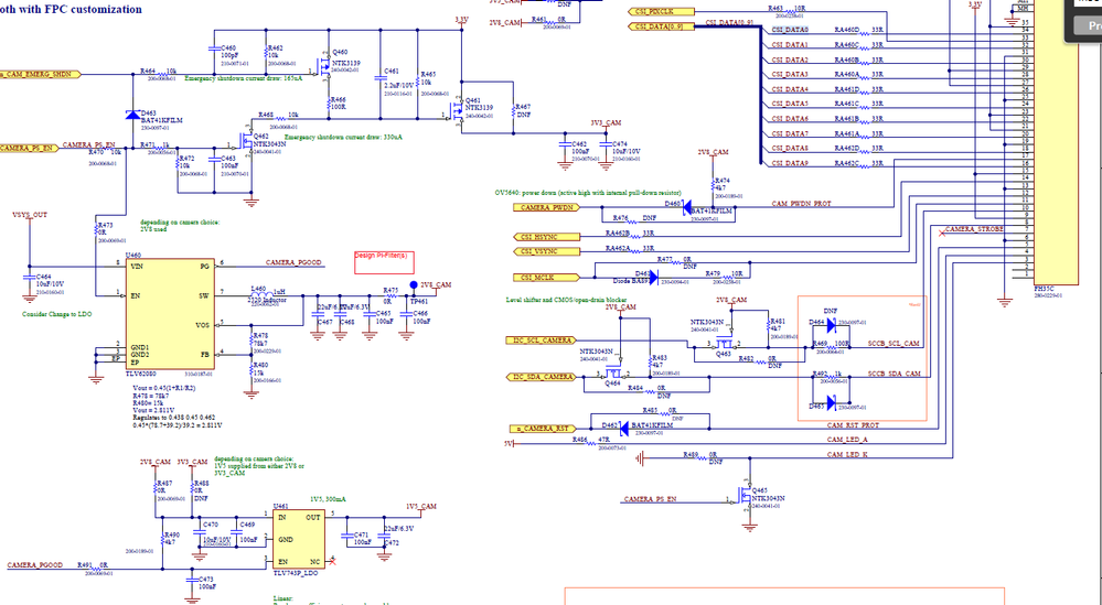

Hello Everyone,
I am trying to interface our custom board based on imx6ul with ov5640 camera sensor. I have updated device tree according to the schematics, but I dont see in logs ov5640 driver is probed at all(i have add debug code in ov5640.c(drivers/media/i2c/ov5640.c)

my schematics is as shown below
i dont see ov5640.c as well as csi driver getting probed(i have added debug code in both of them. I have enabled csi.
please find attatched dts and log file.
Any help would be really helpful.
413 Views
weidong_sun
  You loaded wrong driver of ov5640, correct driver is drivers/media/platform/mxc/capture/ov5640.c
correct it, please!
Have a nice day!
BR,
weidong
