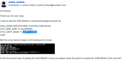

sneha_mohan
Hi Chavira,
Thank you for your reply.
I tried to add the 4GB DRAM in core/arch/arm/plat-imx/conf.mk
ifneq (,$(filter $(PLATFORM_FLAVOR),mx8mmevk))
CFG_DDR_SIZE ?= 0xc0000000
CFG_UART_BASE ?= UART4_BASE
endif
But the Linux kernel image is not booting and is stuck.
Is this the correct way of adding the 4GB DRAM? Could you please share the patch to enable the 4GB DRAM in the conf.mk?
