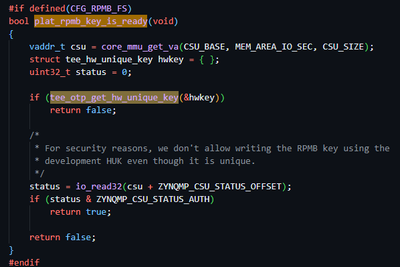

Hi! I am already running as sudo user. Here I have gone to more details and found some reason for error.
I dry run the optee code (I can't see optee logs due to some reason ) and I found out the error was coming from here. I just wanna ask that I just want to fuse the testkey, what it has to do with HW Unique key and which flags I need further to write the test key on rpmb. Should I need to Fuse OTP necessarily?
 For security reasons, we don't allow writing the RPMB key using the  development HUK even though it is unique.

CrazyDeveloper
Sorry this function is called for IMX I guess, the other one is called for plat-zynqmp
