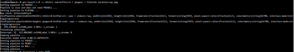

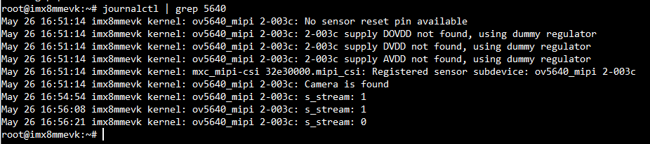

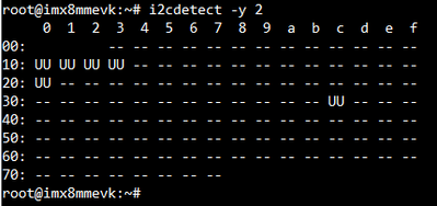

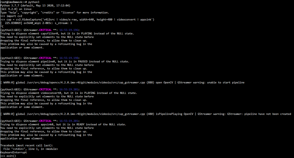

I am unable to reproduce this issue on imx8mm evk because I am currently unable to read frames at all from ov5640 camera on evk. I get the below errors while trying to read frames from camera ov5640 on evk.
1. To make sure that camera is attached properly to evk, below are the confirmations.
2. When I try to read frames from opencv-python, I get the below error.
3. When I try to construct a gstreamer pipeline, I get the below error.
So, I am unable to verify this on evk currently.
