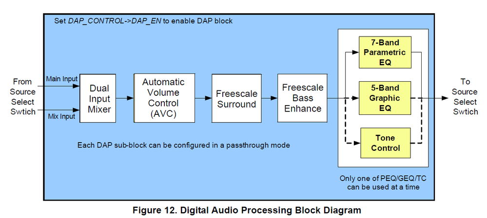

There's no sound output after DAP enabled. We set audio route as: I2S_IN -> DAP -> DAC -> LINEOUT/HP_OUT
    snd_soc_write(codec, SGTL5000_DAP_CTRL, 0x0001);
    snd_soc_write(codec, SGTL5000_CHIP_SSS_CTRL, 0x70);
    snd_soc_write(codec, SGTL5000_DAP_PEQ, 0x0002);
    snd_soc_write(codec, SGTL5000_DAP_AUDIO_EQ, 0x0001);
 Any ideas or suggestions?

Hello Qingwei,
Seems that you've forgot to enable the DAP block in the CHIP_DIG_POWER register. Please check.

lqw39
It works after DAP power enabled.
Thank you , Artur.

     I consulted SGTL5000 datasheet on how to program DAP, and found your steps are not complete.
1. See DAP diagram
We should pay attention to notes about PEQ/GEQ/TC: Only one of them can work simultaneously, so you can only use one, but not more.

   From example code, except setting DAP_EN, each sub-block of DAP should also be configured, so please read them and re-debug your codec.

lqw39
Hi Weidong,
Thanks for your help. I just posted a fragment of DAP config.
Each DAP sub-block should work in pass through mode by default, so sound should always output from line-out when audio route switched to  I2S_IN -> DAP -> DAC -> LINEOUT from I2S_IN -> DAC -> LINEOUT
We only need PEQ/GEQ function, and other sub-blocks work in pass through mode.
Could you give me a simple sample (regardless of any parameter value)?
