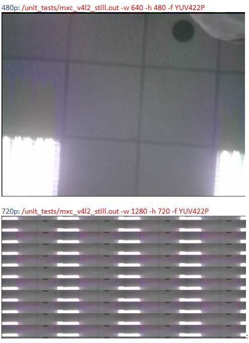

Hi Sir,
I will use mxc_v4l2_still.out function to capture YUV422 format image, and follow FSL-UT-V4L2-002.txt from mxc_v4l2_test/doc .
The image view is normal when capture resolution of "640x480" . But I change resolution from 640x480 to 1280x720 (or 1920x1080), the image view is NG.
Below is Test Procedure :
mxc_v4l2_still.out -w 640 -h 480 -f YUV422P
The image can be viewed with:
mxc_v4l2_output.out -iw 640 -ih 480 -ow 640 -oh 480 -l 100 -f 422P still.yuv
The image should be the correct image, clear and with the correct colors.

some sensors require additional coefficients loaded through i2c for supporting
additional resolutions, what sensor used in the case, had you tried with gstreamer.
Please refer to attached Linux Guide sect.7.3 Multimedia use cases. Supported resolutions
can be checked with  $ gst-inspect mfw_v4lsrc
igor

The test environment is Sabre-SD boad and camera sensor is OV5642 (OV5640 MIPI have some situation).
My customer need capture YUV domain but linux user's guide not have.

My environment :
root@imx6qsabresd:/unit_tests# uname -a
Linux imx6qsabresd 4.1.15-2.0.0+gb63f3f5 #1 SMP PREEMPT Thu Jun 15 17:59:54 CST 2017 armv7l armv7l armv7l GNU/Linux

Hi WKJIMMY
what about other /mxc_v4l2_test tests, are they working fine
