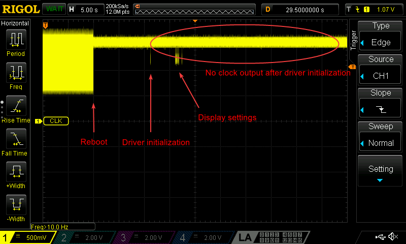

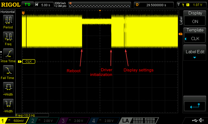

I also used an oscilloscope to capture LVDS ouput clock, with disabled video config in u-boot to get rid of unnecessary clock waveform, we have the following results:
This is the working one:
This is the failing one:

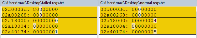

I also dumped all IPU, CCM, CCM Analog related registers when this issue happened, here're the registers compare (after we have the "timeout flip irq" kernel message):
And further investigation shows 0x02a40174 is the first register which could tell this issue is happening, there's a "DI1_CNTR_FIFO_EMPTY" flag got cleared in this register.

I think there're several different root causes for this "timeout when waiting for flip irq" log output. If you could use devmem2 to check that the value of IPUx_DIx_STAT is 0x00000001 instead of 0x00000005 when this issue happens, there'll be a good probability that you're running into the same issue as me.
