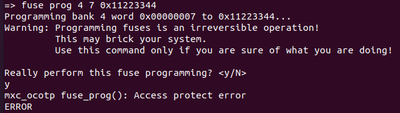

We are using IMX6ULL in our device. We are planning to fuse HW version information in the general purpose customer defined info register. We tried to fuse value by using the below commands in U-boot.
fuse prog 7 0 0x11223344
We are getting an error below.
mxc_ocotp fuse_prog(): Access protect error
Similarly I was unable to fuse value into OCOTP_GP2 also.
Let me know why I am unable to write into these registers. Am I need to enable any other bits of register to get access of writing into it.
Surprisingly at the same time I was able to fuse the value to the other general purpose register OCOTP_GP1. Please confirm that whether can I use this register for storing my information?

I am using the command fuse prog 5 2 0x11223344 to fuse the GP2 register in the U-boot. I have done this after fusing GP1 register. Fusing GP1 register was successful.

OCOTP_GP2 is available at Bank 4 & Word 7.
Please refer to 37.5 OCOTP Memory Map/Register Definition in RM for more information.
Please share the output of the below command for further debugging.
=> fuse read 0 0

roshanmohammed
Below is the output after trying to fuse Bank 4 & Word 7.
Below is the value for Bank 0 & Word 0
Word 0x00000000: 003a7237
3,943 Views
Dhruvit
Hi @roshanmohammed,
I hope you are doing well.
fuse (bank 0, word 0) is an OCOTP_LOCK fuse.
Here bit 12 & 13 are set (GP2_LOCK[13:12] at 0x400) are set.
So, fuse GP2 seems to be locked (write & override protect).
Please refer to 37.5.12 Value of OTP Bank0 Word0 (Lock controls)
(OCOTP_LOCK) in RM for more information.

Hi @Dhruvit Thanks for this information. I think we have resolved.

The OCOTP general-purpose fuse banks GP3 and GP4 are locked and cannot be programmed.
Please refer to ERR011163 in Chip Errata for the i.MX 6ULL
