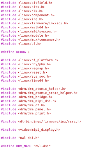

hansung_jung
Thanks for your reply.
I tried to enable debug flag in nwl-dsi.c like below, but it doesn't show debug message.
So could you please let me know how to enable debug flag in driver?

Zhiming_Liu
Hi @hansung_jung
The log should contain 'imx-drm display-subsystem', need check dts nodes.
