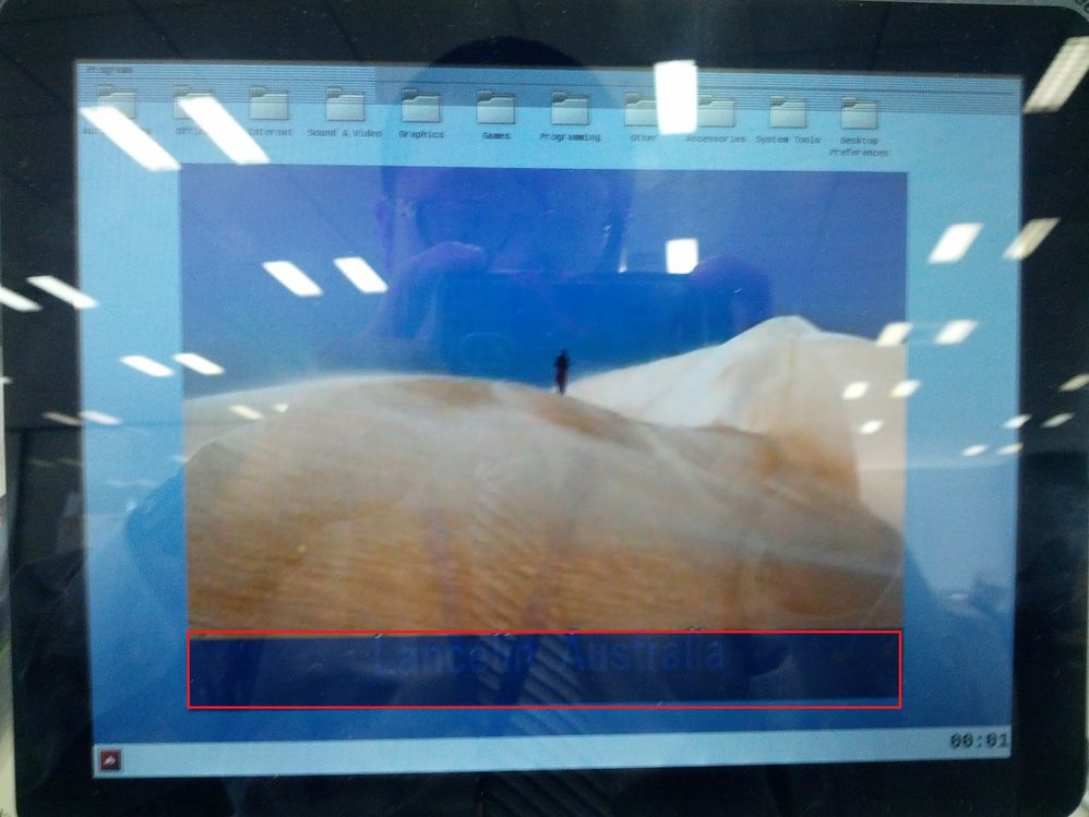

2, Flickering playing status image with vssconfig-->format=RGB3 by mfw_isink
① /usr/share/vssconfig
  # vss device definition
  # Master=DVI, Slave=TV
  # please add "video=video=mxcdi1fb:YUV444,720P60 video=mxcdi0fb:RGB24,1024x768M-16@60" to kernel startup command line
  # master display
  [master]
  type = framebuffer
  format = RGB3
  fb_num = 1
  main_fb_num = 0
② /root/test.sh script
  #! /bin/sh
    export VSALPHA=1
    gst-launch filesrc location=WhereTheHellIsMatt_720p.mp4 typefind=true ! aiurdemux ! vpudec ! mfw_isink axis-top=100 axis-left=100 disp-width=800 disp-height=600
Who can tell me what is the reason about this problem for mfw_isink?
1, When playing the video with screen size set over 640x480(include this size), it must be flickering or strange color.
2, When playing the video screen screen size set less than 640x480, it palys normally and with correct color.
The gst-fsl-plugins' version is 3.0.7

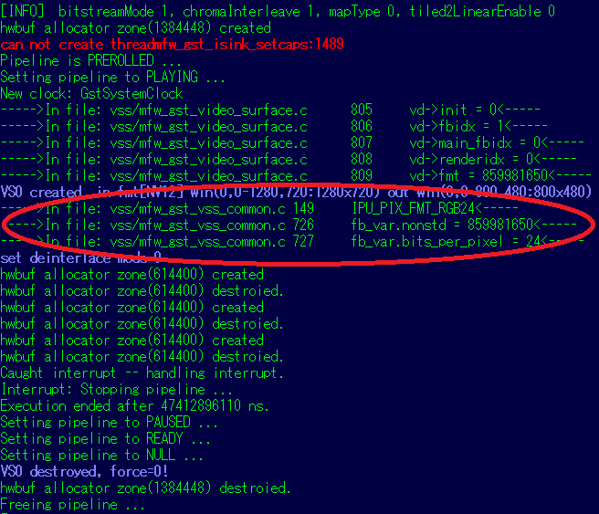

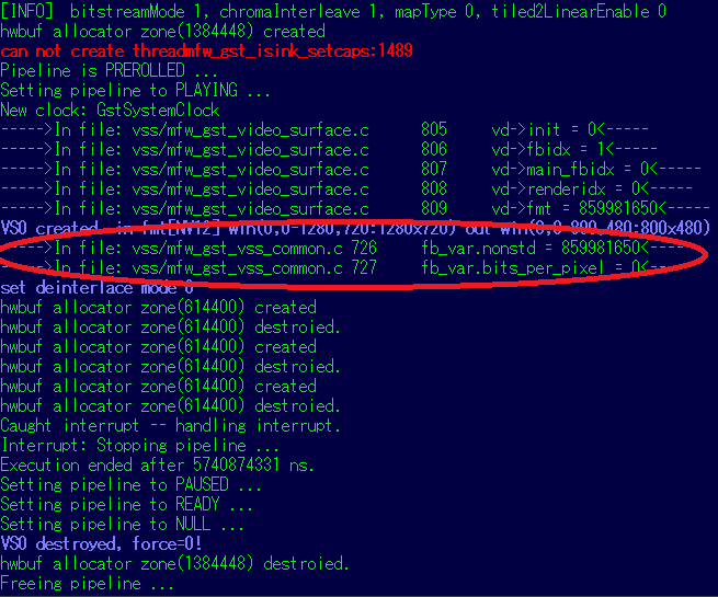

I have just fixed this problem
Reason:      mfw_gst_vss_common.c can not supply to convert the RGB24(RGB3) to correct pixel format.
File:            gst-fsl-plugins-3.0.7/libs/vss/mfw_gst_vss_common.c
Function:     int fmt2bit (unsigned long fmt)
Fixing:        Line 147 adding
                 case IPU_PIX_FMT_RGB24:  // added by TongChunyang for fixing the problem of vssconfig set as RGB3
Evidence:
1, bug status log
2, fixed status log
