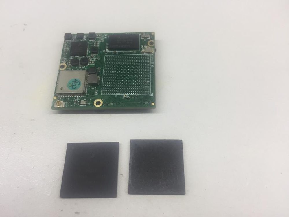

In this link: https://community.nxp.com/thread/452013 (stepes 1 to 5) I used the mfgtool2-brillo-mx7d-multa-emmc-firmware script instead of the mfgtool2-brillo-mx7d-pico-emmc-firmware script. The mfgtool2-brillo-mx7d-multa-emmc-firmware script have a command ""eMMC-Brillo-uboot-fuse"" (look pic below...
I bricked my device because this part of the ""eMMC-Brillo-uboot-fuse"" option/script in ucl2.xml
<CMD state="Updater" type="push" body="$ ls /sys/fsl_otp ">Showing HW_OCOTP fuse bank</CMD>
<CMD state="Updater" type="push" body="$ echo 0x10002810 > /sys/fsl_otp/HW_OCOTP_BOOT_CFG0">write 0x11204154 to /sys/fsl_otp/HW_OCOTP_BOOT_CFG0 fuse bank</CMD>
<CMD state="Updater" type="push" body="$ cat /sys/fsl_otp/HW_OCOTP_BOOT_CFG0 ">Read value from HW_OCOTP_CFG1 fuse bank</CMD>
My questions is:
1) If I change the SOM application processor NXP i.MX7 ARM Cortex-A7+M4 (by this: https://br.mouser.com/ProductDetail/NXP-Semiconductors/MCIMX7D5EVM10SD?qs=sGAEpiMZZMve4%2FbfQkoj%252... ) I will solved my issue?
2) Is there any way to fix the issue without changing SOM application processor NXP i.MX7 ARM Cortex-A7+M4?
3)  What kind of bga solder of the NXP i.MX7 ARM Cortex-A7+M4 in SOM pico-imx7d?
(BGA-488/BGA-541/lfbga-541/mapbga-488/tpbga-488)
Can anyone help me

igorpadykov
Hi NEUBER

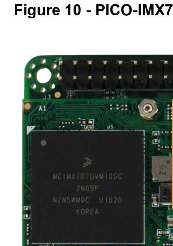

1.3. diferencies between MCIMX7D5EVM10SD and used pico-i.MX7D on below image
can be found in Table 1. Orderable parts i.MX 7Dual Family of Applications Processors Datasheet
2. if blown wrong fuse, only way is to replace part
igor

neuberfran
igorpadykovigorpadykov Hi, I change MCIMX7D7DVM10SC (pic attached) BUT not SOLVED. I spent $ 162.23 on the exchange. Why?

neuberfran
igorpadykov I put MCIMX7D7DVM10SD (https://br.mouser.com/ProductDetail/NXP-Semiconductors/MCIMX7D7DVM10SD?qs=HXFqYaX1Q2ylinazaOzj7A%3D%... )
bought from mouser. What is wrong with it?
What about this:
You should modify software sources for "MCIMX7D5EVM10SD" part.
How can I do this? Will I have to remove the new chip and do this rewriting?
5,560 Views
igorpadykov
if new part is exactly the same as was on board, probably you damaged
something else on board, some other components. So you should obtain schematic
of that board and debug it using software sources of that board.
May be useful in that case AN4553 Using Open Source Debugging Tools for Linux on i.MX Processors
