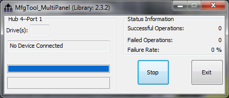

The mfgtool stops with "No Device Connected" with "Failure Rate: 0%".  Running it on WIndows97 64-bit.  Created the u-boot and kernel image as per"Manufacturing Tool V2 Linux or Android Firmware Development Guide V2.docx" and use the initramfs.cpio.gz.uboot that comes with mfgtool.
The mfgtool appears to load u-boot, kernel, rootfs, and dtb correctly.  Then the log file says "Jump to Ramkernel successfully!"  But the tool displays "No Device Connected" with "Failure Rate: 0%".  The serial log shows "UTP: Waiting for device to appear".  The logs are attached.
What is the error stopping mfgtool from flashing the eMMC?

Thanks for your answers.  Found the problem - my board was in USB host mode and needed to be changed to USB device mode.  Now it flashes the eMMC.

I've had a long and difficult struggle to get a working Mfgtool build from Yocto source (Fido) for custom imx6 hardware. Here are some tips:
  1. Install and use USB View (USBView - Windows 10 hardware dev) to see how the imx6 is appearing on the PC's USB bus. With this tool you'll see the imx6 appear as vid=15A2, pid=0054 during the first stage (when transferring U-Boot, Kernel and File system), and then you'll see this disappear and reappear as vid=066F, pid=37FF during the second stage (when the mfgtool kernel is booted).
  2. If the imx6 doesn't appear on USB during the second stage, and the message 'UTP: Waiting for device to appear' is shown on the debug UART, check the following:
    1. Check USB ID line is not pulled low either by hardware or pin mux in device tree file.
    2. Check the mfgtool kernel config. The i.MX 6 Linux® Reference Manual Document Number: IMX6LXRM
      Rev. L3.14.28_1.0.0-ga, 03/2015 has a useful section on the USB driver options, which helped me get it working, e.g.:
      1. CONFIG_USB-Build Support for Host-side USB
      2. CONFIG_USB_EHCI_HCD EHCI HCD (USB 2.0) support Default y
      3. CONFIG_USB_CHIPIDEA- ChipIdea Highspeed Dual Role Controller Default y
      4. CONFIG_USB_CHIPIDEA_UDC - ChipIdea device controller Default y
      5. CONFIG_USB_CHIPIDEA_HOST - ChipIdea host controller Default y
      6. CONFIG_USB_GADGET - USB Gadget Support Default y
      7. CONFIG_USB_MXS_PHY - Freescale MXS USB PHY support Default y
      Ensure the special USB UTP stuff is enabled:8. CONFIG_USB_MASS_STORAGE=y
      9. CONFIG_FSL_UTP=y
               10. CONFIG_USB_GADGET=y

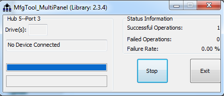

Hi Peter,
Here is my mfgtool.log
