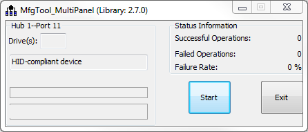

I used mfgtool to burn imx8mq evk SD card and eMMC, all fails. Here is my step:
1. Followed the steps described in chapter "4.2 Manufacturing Tool" in <i.MX Linux® User's Guide>.
Imx8mq evk is supported by default, so I didn't modify the uc12.xml.
2. Switch is SW801 '0010', SW802 '01', unplug SD card.
2. Connect the cable, turn on power
2.1 If burn SD, insert SD card, double-click "mfgtool2-yocto-mx8-evk-sd2.vbs"
2.2.If burn eMMC, double-click "mfgtool2-yocto-mx8-evk-emmc1.vbs"
3. MfgTool shows
   "Hub 1--Port 11"
    Driver(s) is (nothing shows) (this is different, I don't know why)
    HID-compliant device

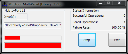

4. Click start, then will fail with prompt "Boot" body="BootStrap" error, file="E:\mfgtools\Profiles\linux\OS Firmware\firmware\imx-boot-imx8mqevk-sd.bin-flash_evk"
I checked the file is exists.
Can anyone tell me what are my mistakes? Thanks!

Please use a usb2.0 hub or usb2.0 PC port
2,619 Views
deexithamba
Faced the same issue on windows 7. On Windows 10, flashing passed!
Deexith
2,619 Views
pengcheng
Change another computer solve this issue, please have a try!
Can not know the root cause!

I tested emmc programing on my imx8evk board successfully, I used the same mfgtool version, set SW802  to '01', pls try to use another board to test again. and it seems you don't conncet the board correctly, my mfgtool shows HID-compliant vendor-defined device, could you see anything in the "Human Interface Device" of "Device Manager"? or try to change another board or PC to test again.
2,619 Views

1 yes, it's correct, I got "HID-compliant vendor-defined device"
2 yes typc C is correct
3 SW801 is for booting, I don't care about this
4 do you try to download other mfgtool version to try it? pls check if you download mfgtool successfully? I couldn't reproduce this issue for you, my board is SCH-29615 REV B3 and 700-29615 REV A

1. I tried L4.9.51_IMX8MQ_GA_MFGTOOL and L4.9.88_2.0.0_mfg-tool_MX8MQ, all fails.
2. My borads versions are same to you.
3. Error log showed:
"xxxx\L4.9.51_8mq-ga_mfg-tools.tar\L4.9.51_8mq-ga_mfg-tools\mfgtools\Profiles\linux\OS Firmware\firmware\imx-boot-imx8mqevk-sd.bin-flash_evk
ModuleID[2] LevelID[1]: MxHidDevice::AllocateIoBuffers().CreateFile ERROR:(2)
ModuleID[2] LevelID[1]: ERROR: AllocateIoBuffers failed. 2
ModuleID[2] LevelID[1]: RunPlugIn(): TransData(0x7E1000, 0x28600,0x284A050) failed.
ModuleID[2] LevelID[1]: PortMgrDlg(0)--MxHidDevice--Command Boot excute failed
ModuleID[2] LevelID[10]: CmdOperation[0], current command executed failed, so SetEvent(hDevCanDeleteEvent)"
BR,
Peng
2,619 Views
joanxie
I couldn't reproduce this on my board, it seems the allocate buffer issue, did you try to format the SD card first then try again? or did you try to use the new SD card? and try to confirm if your card aren't locked
