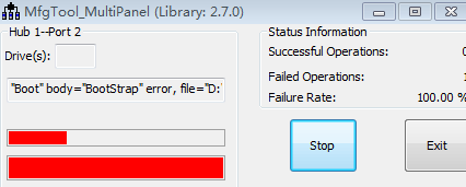

I used mfgtool to burn imx8mq evk SD card and eMMC, all fails. Here is my step:
1. Followed the steps described in chapter "4.2 Manufacturing Tool" in <i.MX Linux® User's Guide>.
Imx8mq evk is supported by default, so I didn't modify the uc12.xml.
2. Switch is SW801 '0010', SW802 '01', unplug SD card.
2. Connect the cable, turn on power
2.1 If burn SD, insert SD card, double-click "mfgtool2-yocto-mx8-evk-sd2.vbs"
2.2.If burn eMMC, double-click "mfgtool2-yocto-mx8-evk-emmc1.vbs"
3. MfgTool shows
   "Hub 1--Port 11"
    Driver(s) is (nothing shows) (this is different, I don't know why)
    HID-compliant device
4. Click start, then will fail with prompt "Boot" body="BootStrap" error, file="E:\mfgtools\Profiles\linux\OS Firmware\firmware\imx-boot-imx8mqevk-sd.bin-flash_evk"
I checked the file is exists.
Can anyone tell me what are my mistakes? Thanks!

i have the same problem!   this is my log:
ModuleID[2] LevelID[10]: *********MxHidDevice[098A3CF8] Jump to Ramkernel successfully!**********
ModuleID[2] LevelID[10]: CmdOperation[0], current state command has been finished and the last command is successful, so SetEvent(hDevCanDeleteEvent)
ModuleID[2] LevelID[10]: DeviceManager::DevChangeWnd::OnDeviceChange() - DEVICE_REMOVAL_EVT(\\?\USB#VID_1FC9&PID_012B#5&3863b160&0&2#{a5dcbf10-6530-11d2-901f-00c04fb951ed})
ModuleID[2] LevelID[10]: DeviceManager::DevChangeWnd::OnDeviceChange() - end
ModuleID[2] LevelID[10]: DeviceManager::OnMsgDeviceEvent() - DEVICE_REMOVAL_EVT(\\?\USB#VID_1FC9&PID_012B#5&3863b160&0&2#{a5dcbf10-6530-11d2-901f-00c04fb951ed})
ModuleID[2] LevelID[10]: DeviceClass::FindDeviceByUsbPath--DeviceListType_Current, _devices.size: 1
ModuleID[2] LevelID[10]: DeviceClass::FindDeviceByUsbPath--DeviceListType_Current, devInstPathToFind: USB\VID_1FC9&PID_012B\5&3863B160&0&2, _deviceInstanceID: USB\VID_1FC9&PID_012B\5&3863B160&0&2
ModuleID[2] LevelID[10]: DeviceClass::FindDeviceByUsbPath--DeviceListType_Current, Find the device
ModuleID[2] LevelID[10]: DeviceManager::OnMsgDeviceEvent() - DEVICE_REMOVAL_EVT,[MxHidDeviceClass] vid_1fc9&pid_012b, Hub:0-Port:0
ModuleID[2] LevelID[10]: DeviceManager::OnMsgDeviceEvent() - DEVICE_REMOVAL_EVT, Notify
ModuleID[2] LevelID[10]: CmdOperation[0] device chagned and reset to state 0
ModuleID[2] LevelID[10]: CmdOperation[0], skip current command, so SetEvent(hDevCanDeleteEvent)
ModuleID[2] LevelID[10]: ExecuteCommand--Boot[WndIndex:0], File is D:\tftp_imx8_image\L4.9.88_2.0.0_mfg-tool_MX8MQ\mfgtools\Profiles\linux\OS Firmware\firmware\imx-boot-imx8mqevk-sd.bin-flash_evk
ModuleID[2] LevelID[1]: MxHidDevice::AllocateIoBuffers().CreateFile ERROR:(2)
ModuleID[2] LevelID[1]: ERROR: AllocateIoBuffers failed. 2
ModuleID[2] LevelID[1]: RunPlugIn(): TransData(0x7E1000, 0x28800,0x99EA050) failed.
ModuleID[2] LevelID[1]: PortMgrDlg(0)--MxHidDevice--Command Boot excute failed
ModuleID[2] LevelID[10]: CmdOperation[0], current command executed failed, so SetEvent(hDevCanDeleteEvent)

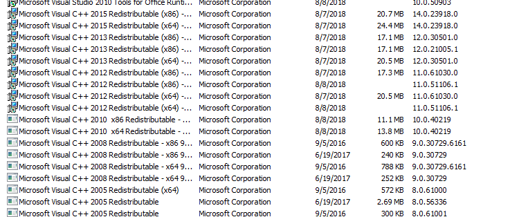

  System Requirements
System requirements are based on the requirements for the development tools and the MfgTool application.
The recommended PC configuration is 2GHz processor, 2GB RAM, and 2GB free disk space.
Windows OS applications like MfgTool require installation of Visual C++ redistributable 2013 or greater.
Yuri.

I've tried this with three separate computers; one running Windows 10, one running windows 7, yielding the same results on both boards.  All of these computers have system specs beyond the capabilities of a computer from 2002 which are the following:
Windows 10 computer --> Intel Core i7-6700 @ 2.6GHz; 16GB RAM - 1TB HD (515GB free)
Windows 7 computer --> Intel Core i5-5200 2.2GHz; 12GB RAM - 500GB HD; (120GB free)
Windows 7 computer --> Intel Core i7-6700 @ 2.6GHz; 16GB RAM - 1TB HD (721GB free)
...and yes, Visual C++ is installed...all of them
The MfgTool2 log from running "mfgtool2-yocto-mx8-evk-emmc1.vbs" is attached; so is the raw console output from the IMX8M-EVK board during the attempted installation.

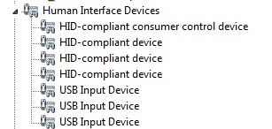

joanxie
I tested emmc programing on my imx8evk board successfully, I used the same mfgtool version, set SW802  to '01', pls try to use another board to test again. and it seems you don't conncet the board correctly, my mfgtool shows HID-compliant vendor-defined device, could you see anything in the "Human Interface Device" of "Device Manager"? or try to change another board or PC to test again.

1. Is this "Human Interface Device" in"Device Manager" correct?
2. I use the type-C usb otg, is this correct?
3. What configure of SW801 on your board? Does this matters?
4. I changed another board, still can not burn image.
BR,
Peng
6,192件の閲覧回数
joanxie
1 yes, it's correct, I got "HID-compliant vendor-defined device"
2 yes typc C is correct
3 SW801 is for booting, I don't care about this
4 do you try to download other mfgtool version to try it? pls check if you download mfgtool successfully? I couldn't reproduce this issue for you, my board is SCH-29615 REV B3 and 700-29615 REV A
