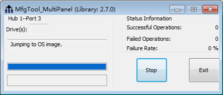

烧写IM8时,识别为大文件存储设备后,就停止无法烧写。

     Decompress the L4.9.88_2.0.0_mfg-tool_MX8MQ.tar.gz,  then  unzip mfgtools-with-rootfs-mx8.zip, i   click
mfgtool2-yocto-mx8-evk-emmc1.vbs  to burn . then stop at ,

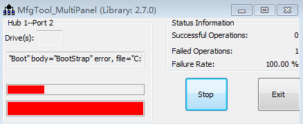

past  long time , then occur:
and  always occur:

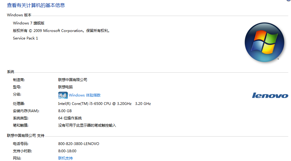

by the way , my computer is lenovo 。
I'm sure this problem is the windows driver problem. beacause  my company have one computer ok.but others
can not work.

没有解决,换了一台老机器可以烧写。我猜测是新电脑的usb驱动问题

this  is the log :
DLL version: 2.7.0
Tuesday, September 18, 2018 17:18:58 Start new logging
ModuleID[2] LevelID[10]: CMyExceptionHandler thread is running
ModuleID[2] LevelID[1]: new MxHidDeviceClass
ModuleID[2] LevelID[10]: new MxHidDevice[07BD6A80]
ModuleID[2] LevelID[10]: new MxHidDevice[007CC570]
ModuleID[2] LevelID[10]: new MxHidDevice[07BD5610]
ModuleID[2] LevelID[10]: Device Manager thread is running
ModuleID[2] LevelID[1]: Can't set m_hStopEvent before it initialized or it already stop
ModuleID[2] LevelID[10]: CmdOperation[0] device chagned and reset to state 0
ModuleID[2] LevelID[10]: CmdOperation[0], skip current command, so SetEvent(hDevCanDeleteEvent)
ModuleID[2] LevelID[10]: ExecuteCommand--Boot[WndIndex:0], File is D:\tftp_imx8_image\mfgtools\Profiles\linux\OS Firmware\firmware\imx-boot-imx8mqevk-sd.bin-flash_evk
ModuleID[2] LevelID[1]: HAB type mismatch: 0xcf1133!!!
ModuleID[2] LevelID[10]: *********MxHidDevice[07BD5610] Jump to Ramkernel successfully!**********
ModuleID[2] LevelID[10]: ExecuteCommand--Load[WndIndex:0], File is D:\tftp_imx8_image\mfgtools\Profiles\linux\OS Firmware\firmware\Image, address is 0x40480000
ModuleID[2] LevelID[10]: PortMgrDlg(0)--Command Load excute successfully, retry count: 0
ModuleID[2] LevelID[10]: ExecuteCommand--Load[WndIndex:0], File is D:\tftp_imx8_image\mfgtools\Profiles\linux\OS Firmware\firmware\fsl-image-mfgtool-initramfs-imx_mfgtools.cpio.gz.u-boot, address is 0x43800000
ModuleID[2] LevelID[10]: ExecuteCommand--Load[WndIndex:0], File is D:\tftp_imx8_image\mfgtools\Profiles\linux\OS Firmware\firmware\fsl-imx8mq-evk.dtb, address is 0x43000000
ModuleID[2] LevelID[10]: ExecuteCommand--Jump[WndIndex:0]
ModuleID[2] LevelID[10]: CmdOperation[0], current state command has been finished and the last command is successful, so SetEvent(hDevCanDeleteEvent)
ModuleID[2] LevelID[10]: DeviceManager::DevChangeWnd::OnDeviceChange() - DEVICE_REMOVAL_EVT(\\?\USB#VID_1FC9&PID_012B#5&3863b160&0&4#{a5dcbf10-6530-11d2-901f-00c04fb951ed})
ModuleID[2] LevelID[10]: DeviceManager::DevChangeWnd::OnDeviceChange() - end
ModuleID[2] LevelID[10]: DeviceManager::OnMsgDeviceEvent() - DEVICE_REMOVAL_EVT(\\?\USB#VID_1FC9&PID_012B#5&3863b160&0&4#{a5dcbf10-6530-11d2-901f-00c04fb951ed})
ModuleID[2] LevelID[10]: DeviceClass::FindDeviceByUsbPath--DeviceListType_Current, _devices.size: 1
ModuleID[2] LevelID[10]: DeviceClass::FindDeviceByUsbPath--DeviceListType_Current, devInstPathToFind: USB\VID_1FC9&PID_012B\5&3863B160&0&4, _deviceInstanceID: USB\VID_1FC9&PID_012B\5&3863B160&0&4
ModuleID[2] LevelID[10]: DeviceClass::FindDeviceByUsbPath--DeviceListType_Current, Find the device
ModuleID[2] LevelID[10]: DeviceManager::OnMsgDeviceEvent() - DEVICE_REMOVAL_EVT,[MxHidDeviceClass] vid_1fc9&pid_012b, Hub:0-Port:0
ModuleID[2] LevelID[10]: DeviceManager::OnMsgDeviceEvent() - DEVICE_REMOVAL_EVT, Notify
ModuleID[2] LevelID[1]: MxHidDevice::AllocateIoBuffers().CreateFile ERROR:(2)
ModuleID[2] LevelID[1]: ERROR: AllocateIoBuffers failed. 2
ModuleID[2] LevelID[1]: RunPlugIn(): TransData(0x7E1000, 0x28800,0x711A050) failed.
ModuleID[2] LevelID[1]: PortMgrDlg(0)--MxHidDevice--Command Boot excute failed
ModuleID[2] LevelID[10]: CmdOperation[0], current command executed failed, so SetEvent(hDevCanDeleteEvent)
ModuleID[2] LevelID[10]: CCmdOpreation[0] thread is Closed
