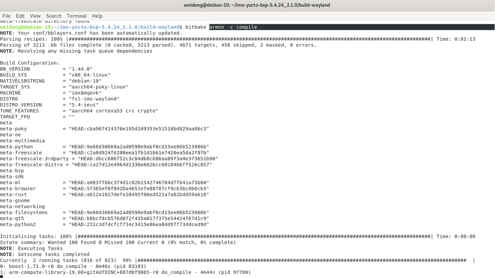

weidong_sun
Hello Mani,
ubuntu 18.04 is recommended. I tested it on ubuntu 18.04 /20.04 LTS and Debian-10, compliation is no problem.
Below is packages for compiling Linux bsp on ubuntu 18.04 and debian-10, after installing linux host, use atp-get install them, please!
# sudo apt-get install flex bison gperf build-essential zlib1g-dev
# sudo apt-get install lib32ncurses5-dev x11proto-core-dev
# sudo apt-get install libx11-dev lib32z1-dev libgl1-mesa-dev
# sudo apt-get install tofrodos python-markdown libxml2-utils xsltproc
# sudo apt-get install uuid-dev:i386 liblzo2-dev:i386 gcc-multilib g++-multilib
[comment]
For debian-10, uuid-dev:i386 liblzo2-dev:i386 should be uuid-dev  liblzo2-dev
# sudo apt-get install subversion openssh-server openssh-client uuid uuid-dev zlib1g-dev
# sudo apt-get install liblz-dev lzop liblzo2-2 liblzo2-dev git-core curl
# sudo apt-get install python3 python3-pip python3-pexpect python3-git python3-jinja2 pylint3
# sudo apt-get install u-boot-tools mtd-utils android-tools-fsutils
[commnent]
For ubuntu 20.04 LTS, don’t need android-tools-fsutils. So remove it, please!
# sudo apt-get install openjdk-8-jdk device-tree-compiler aptitude
[comment]
for debian-10, openjdk-8-jdk should be default-jdk
# sudo apt-get install libcurl4-openssl-dev nss-updatedb
# sudo apt-get install chrpath texinfo gawk cpio diffstat
# sudo apt-get install libncursesw5-dev libssl-dev libegl1-mesa
# sudo apt-get install net-tools python libsdl1.2-dev xterm socat
# sudo apt-get install icedtea-netx-common icedtea-netx
Then
# DISTRO=fsl-imx-wayland MACHINE=imx8mqevk source imx-setup-release.sh -b build-wayland
# bitbake armnn -c compile
weidong
