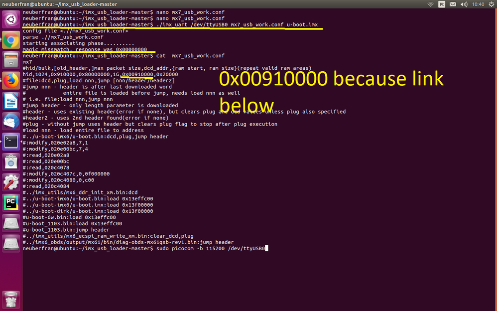

I have the link error below:
https://community.nxp.com/thread/518603
and I'm trying this:
https://github.com/boundarydevices/imx_usb_loader
I have this issue in that place, because not have file mx7d_usb_work.conf :
Please add support to imx7d-pico NXP SOM Module · Issue #109 · boundarydevices/imx_usb_loader · GitH...
My question is:
How can I change this line: hid,1024,0x910000,0x80000000,1G,0x00910000,0x20000 in
mx7_usb_work.conf to work correctly with imx7d-pico and resolve the topic issue?

Hi NEUBER
such error may happen when for example uboot version does not match
to linux kernel, so may be recommended to rebuild all sources from scratch.
As imx7d-pico was developed by technexion, issue may be posted on its forum
https://www.technexion.com/solutions/iot-development-platform/android-things/
igor
