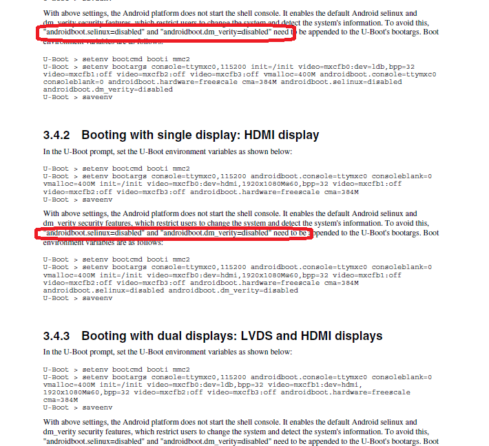

Hi sir ,
I flashed android lolipop  prebuilt image on sabresd board.
I can seen the consle message on terminal.
but i can't login to that file system.
the login prompt is not avalibale. what shall i do to get login prompt on that system.
awaiting your favourable reply
Sachu

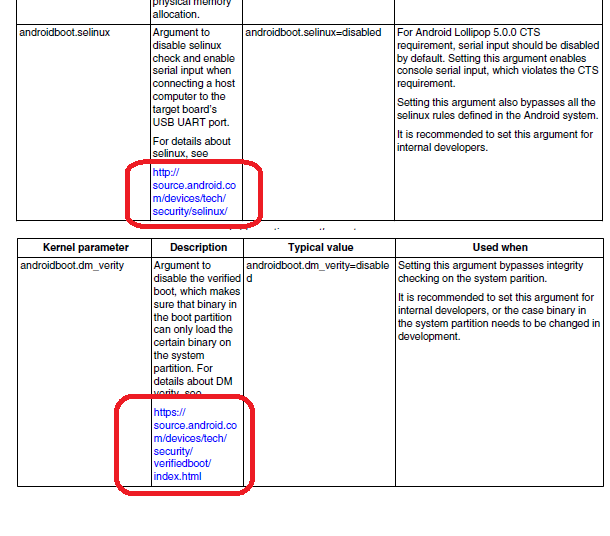

BiyongSUN
Freescale Semiconductor Document Number: AUG
User's Guide Rev. L5.0.0_1.0.0-ga, 06/2015
Android™ User's Guide
Freescale Semiconductor Document Number: AQSUG
Android™ Quick Start Guide

BiyongSUN
