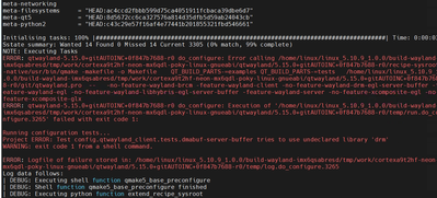

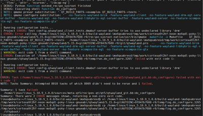

When I built imx-image-full, I found that qtwangland always failed to compile.
Test config.qtwayland_client.tests.dmabuf-server-buffer tries to use undeclared library 'drm'
lib drm ?
I had cleanall-ed them and rebuild , but no effect
How to solve this problem ?

Hi raotianxiang
Try this patch :https://codereview.qt-project.org/c/qt/qtwayland/+/296213
