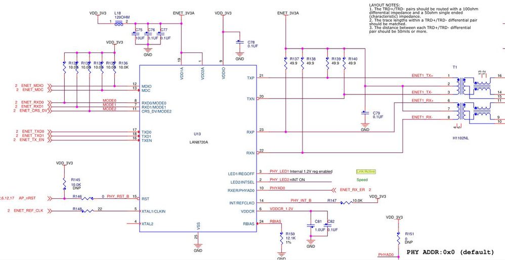

I connected a lan8720 (RMII) with imx6Q. We use the GPIO 16 as clock output for the phy.
i used the following the patch to my kernel.
Re: iMX6 RGMII + ENET_REF_CLK/ENET_TX_CLK
But in both of uboot and kernel , the phy does not work and the link led also does not light.
because the RST pin of lan8720a on our board is connected with POR_B of imx6 control ,
it can't not be set to GPIO. i use soft reset to reset phy.

igorpadykov
Hi fang
I think that connection nRST to POR is not good.
Because LAN8720 VDD1A,VDD2A,VDDIO are turned ON
later in software, such configuration is used on Freescale designs.
Probably for that reason you see "PHY not found" error.
Actually you can check with SDK LAN8720 example, if processor can
detect PHY.
"MX6_PLATFORM_SDK "
http://www.freescale.com/webapp/sps/site/prod_summary.jsp?code=i.MX6Q&nodeId=018rH3ZrDRB24A&fpsp=1&t...
chip

igorpadykov
Hi fang
nRST is hardware reset and this signal latches hardware LAN8720 configuration
(MODE[] signals), seems it is not possible to set it with software reset.
I would suggest to apply to LAN8720 vendor (SMSC) tech
support for workaround.
chip
3,630件の閲覧回数
pfsang
hi, chipexpert
         we connect nRst pin with POR_B , which is global reset. when power on, pmic willl reset imx6 and others peripherals included lan8720a.   seems i needn't to set it with soft reset .
          is that right ?
