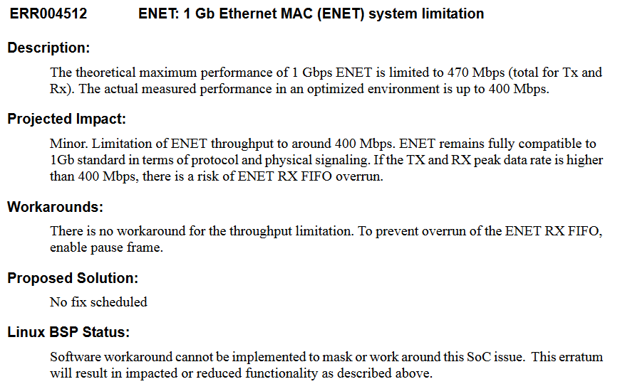

Carlos_Musich
Dear prakeerthi,
in the Errata document you will find that there is a system limitation on 1 Gb Ethernet MAC (ENET). It is ERR004512
https://www.nxp.com/docs/en/errata/IMX6SDLCE.pdf
Carlos
