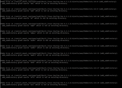

lei11
我修改了isp-imx-4.2.2.22.0/units/cam_device/source/camera/cam_sensor.cpp这个文件,但是我该怎么编译它,让它生成一个新的libcam_device.so
我执行./build-all-isp.sh release partial,似乎不会编译生成新的 libcam_device.so

Bio_TICFSL
You must compile the whole package make sure to include you changes to it.

lei11
I encountered the same problem as him during compilation
https://community.nxp.com/t5/i-MX-Processors/IMX8MP-ISP-isp-media-server-crashes-at-camdev-SensorOps...
when i use    ./build-all-isp.sh release full    ,will report error
