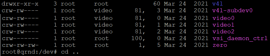

Hi all
There is device list in my Linux system
and Im going to set exposure to my camera sensor. I work on C/C++ application.
I can make a picture and set exposure from command this way:
v4l2-ctl --device=/dev/v4l-subdev0 --get-ctrl=exposure
v4l2-ctl -d /dev/v4l-subdev0 --set-ctrl exposure=512
v4l2-ctl --device=/dev/v4l-subdev0 --get-ctrl=analogue_gain
it uses subdevice concept.
And there is my piece of code, here I work with video0.
open(...) works ok but I can not set any parameter like exposure.
The v4l2_ioctl(...) returns errno= ENOTTY  (the same errno I get with ioct(...) )
ENOTTY - Not a typewriter

btarnowski
The control name is wrong. I had to use V4L2_CID_EXPOSURE and  V4L2_CID_ANALOGUE_GAIN as a control id.
Conclusion - do not trust in examples or other working solutions, your specific code can depend on specific details differ than you see in examples
