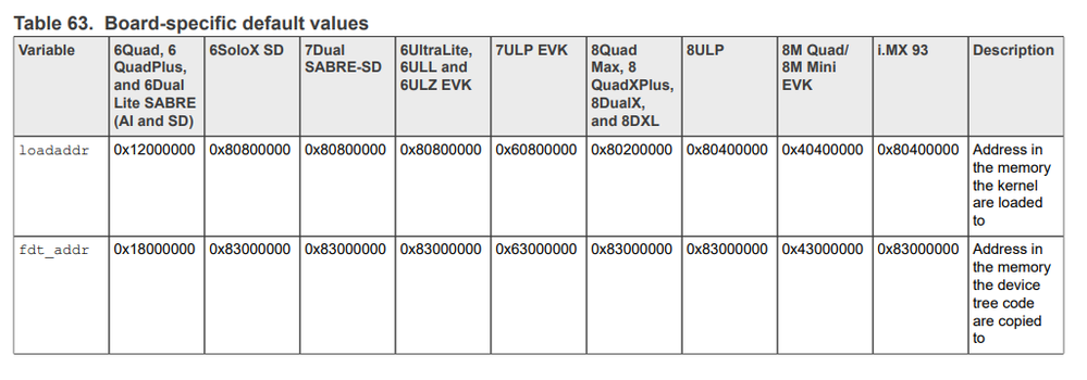

AldoG
Thank you for sharing more information of this, I don't know exactly which i.MX MPU are you using but for bootz you may use the section from loadaddr to fdt_addr variables, for each i.MX you may refer to the i.MX Linux User's Guide page 40 specifying memory addresses.
Aldo.
