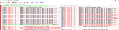

Our product may occur camera not work problem in low possible ,we compare the good/fail log,and can see the below print:
"Failed power operation on resource 384 sc_err 4"

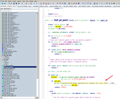

it seems the "#define SC_R_ISI_CH7 384"  resource failed with reason 4:
#define SC_ERR_NOACCESS 4U /* Permission error (no access) */
can you give us some suggest how to debug this issue?Thanks.
