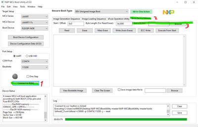

i try MCUBOOTUtility and Secure Provisioning Tool.
But, tools doesn't seem to have jtag loading.
When I used that tool to load to USB, I succeeded.
so how can i slove this problem?

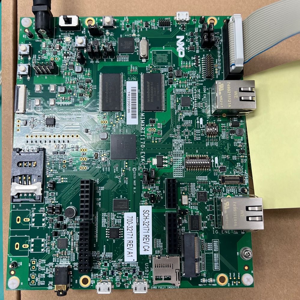

I want to turn on the power without connecting J11 (usb) and insert the firmware using only the JTAG (J1) part.
3,241 Views
Pavel_Hernandez
Hello, are you using the EVK? if yes maybe the MIMXRT1170 EVK Board Hardware User’s Guide could help you, please review chapter 2.12, then could you upload an image about your setup? and tell me, what kind of debugger you are using?
Pavel
3,232 Views
sukyeong
hello,
i review chapter 2.12, remove R187, R208, R195 and R78 is right?
i try this setting, and J38(1-2), SW1(10-Internal BOOT)

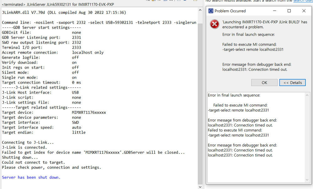

An error occurs when trying to debug as segger with the MCUXpressoIDE also...
I use J-Link Base Segger debugger.
For reference, I am using the IMXRT1170-EVK-PXP example linked with Embedded Wizard.
GPIO_LPSR_13(JTAG_MOD) is need to pull-up??

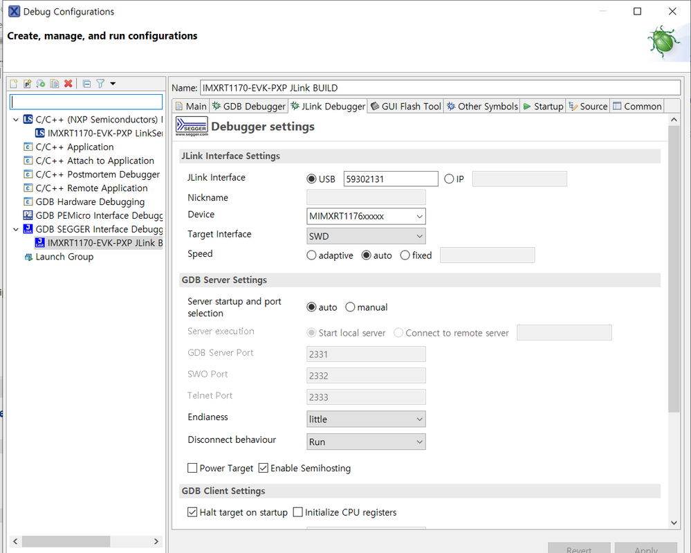

sukyeong
mimxrt-1170-evkmimxrt-1170-evk
-> i remove R187, R208, R195, R78
shut down error image
JLink debug configuration
3,210 Views

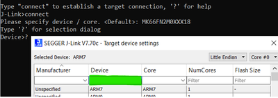

Pavel_Hernandez
Hello, thanks for your information, I found this thread Using J-Link with MIMXRT1160-EVK or MIMXRT1170-EVK - NXP Community please follow the instructions.
Then download the J-Link Commander. [J-Link Commander (segger.com)] and follow this command.
connect
Then this popup window appears to select your target device RT1176xxx [example image].
In the next options click enter, which will be for interface and speed.
If all is right, you cand try the next command to upload the .bin as a test communication.
loadfile C:\Debugin\example.bin
You need to replace the root.
Pavel

Pavel_Hernandez
Hello, in the menu appears 3 options JTAG, SWD and etc. you must select the JTAG option.
Pavel
