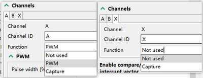

I am using the FlexPWM of imxrt1024 to generate PWM. There is no problem with PWM_A and PWM_B channels, but there is  no PWM output when I using PWM_X. I see that some people have asked this question in the post, but no one make it clear and there is not a solution.

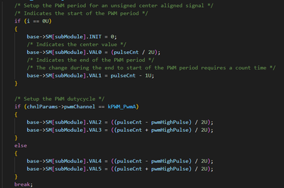

I used MCUXpresso config tools to configure the pins as PMW_X function. I also found that in the peripheral configuration, both channel A and B can select the PWM function, but the X channel does not have this option. In the official SDK, the PWM_SetupPwm function does not seem to be able to configure PWM_X.
Can anyone explain what is going on?

There are only two FlexPWMs on the i.MXRT1024. The PWM_X is not an independent signal, it is an accessory signal, it's rising edge and falling edge are controlled by the VAL0 and VAL1 registers.
PWM_X pin can also optionally output a third PWM signal from each submodule. However, this function is apparently not enabled on the SDK driver, only capture is available.
