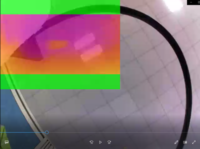

Hardware:imx6q
Sofrware: kernel 4.9.88 gstreamer1.0
Plugin:imxg2dcompositor
Pipeline: gst-launch-1.0 \
imxg2dcompositor name=c background-color=0xff border-alpha=0 \
sink_0::xpos=0 sink_0::ypos=0 sink_0::width=384 sink_0::height=288 sink_0::fill_color=0xff00ff00 sink_0::zorder=55 sink_0::alpha=0.7 sink_0::rotation=0 \
sink_1::xpos=0 sink_1::ypos=0 sink_1::width=640 sink_1::height=480 ! \
queue2 ! "video/x-raw, width=640, height=288,format=RGBA" ! overlaysink \
imxv4l2videosrc device=/dev/video0 ! imxipuvideotransform ! video/x-raw, width=384, height=288, format=RGBA ! c.sink_0 \
imxv4l2videosrc device=/dev/video1 ! c.sink_1
Result: video1 is OK,but video0 scale height is not 288,and be filled with green back-color.Why?and How should I do to fixed it?
video1:640*480 I420
video0:384*288 RGBA
1,267 Views
adorable
The reason is pixel-aspect-ratio has been chaned to others.Using pixel-aspect-ratio=1/1 as caps is OK.

1,275 Views
joanxie
how about removing the alpha option? I found your command is :
is this typo?
