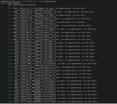

HI NXP
1. Download link for camera setup documentation
2. Where is the issue in the log below?

yxjiang
Why is there an error in the log?

danielchen
From the log file, the GC05A2 sensor at I2C address 1-0037 is detected and linked to the CSI interface.
gc05a2 1-0037 → csidev-4ad30000.csi → crossbar → mxc_isi.2 → /dev/video2
The format negotiation shows
    • GC05A2 outputs SGRBG10_1X10/2592x1944
    • CSI and ISI are configured for UYVY8_1X16/1920x1080
This implies that format conversion is happening, likely via ISI, and the pipeline is correctly routed to /dev/video2.
Below fail log shows the requested format is not supported by the V4L2 device /dev/ivdeo2

yxjiang
HI @danielchen
     1.Check the formats supported by /dev/video2, in case they do not meet expectations
     2.The format is incorrect; it is suspected that the CSI and the camera are not compatible.
