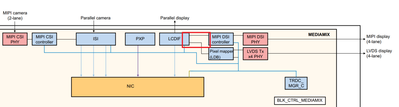

I reported errors when testing hdmi and lvds and hdmi and lcd.

[ 12.164815] [drm] kms: can't enable cloning when we probably wanted to.
And all screens can not be displayed when the same display, display alone is normal. How can I achieve the same display?

If there is only one lcd controller, I can understand that it is not different, and the same display is not supported.
My three displays are hdmi(dsi), lvds, and RGB. Among them, lvds and RGB are directly derived from recipes.
In fact, I also see that you have divided the device tree into multiple display device trees which is also because you can't do the same display

There is only one lcdif in i.MX93, so the chip can’t support dual display interface (MIPI/LVDS/DPI-LCDIF)
One lcdif port
	display-subsystem {
		compatible = "fsl,imx-display-subsystem";
		ports = <&lcdif_disp>;
Three display interfaces from display mux unit :
