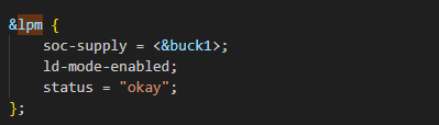

You need to refer to node "lpm" of the device tree and modify the device tree "imx93-11x11-evk.dts" on the lpm node to activate the full feature of our driver.
The node should be on the next way:
&lpm {
    soc-supply = <&buck1>;
    ld-mode-enabled;
    status = "okay";

I would like to ask why my lpm driver failed to load
My device tree configuration is as follows
