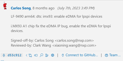

Zhiming_Liu
Hi @Ethane
This is A0 chip issue, please replace A1
Best Regards
Zhiming

Zhiming_Liu
Hi @Ethane
Best Regards
Zhiming
