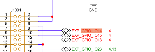

Hello all,
I am currently working with an imx93evk board.
I want to enable the LPUART3 via the GPIO Pins. Looking to the imx93evk Board Design in the IOMUX page I can see that for GPIO_IO14/15 we have as ALT1 the UART3 TX/RX.
Register
Piece of code:
    IOMUXC_SetPinMux(IOMUXC_PAD_GPIO_IO14__LPUART3_TX, 0U);
    IOMUXC_SetPinMux(IOMUXC_PAD_GPIO_IO15__LPUART3_RX, 0U);
    IOMUXC_SetPinConfig(IOMUXC_PAD_GPIO_IO15__LPUART3_RX,
                        IOMUXC_PAD_PD_MASK);
    IOMUXC_SetPinConfig(IOMUXC_PAD_GPIO_IO14__LPUART3_TX,
                        IOMUXC_PAD_DSE(15U));
I also enable the Clock of LPUART3.
Is there anything missing to enable the LPUART via the GPIO pins?

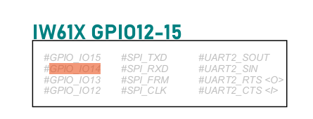

I made the same configuration but now for LPUART6 and everything works fine.
In addition I saw that in the imx93evk there is a reference that IW61X has GPIO12-15 mapped to SPI and UART2. Is this reserving completely the Pins or is there a TMUX where we can switch between M.2 Module and IOMUX ALTX pinout?

Hi @rti ,
The code seems OK, and the default device tree is not using those pads (assuming you have an image with both Linux and M33 firmware running).
However where are you measuring the signals? I'm assuming you have a TTY2USB converter connected to J1001 pin 8 and 10?
The mention in the schematics I think refer to the IW61 pins not the i.MX93, if you are referencing this:
