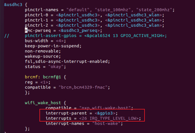

HI,
    My platform is imx93 evk
   SDK VERSION :6.1.22-2.0.0
  HI,
      I am debugging the wifi modules  .It is ap6212
      my dts is modified as follows:
 My critical log is as follows:
  root@imx93evk:~#
root@imx93evk:~# dmesg | grep sdhc

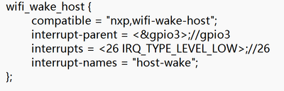

5454ty
我的DTS如附件所示
5,487 Views
Zhiming_Liu
如果你使用GPIO3_IO26作为中断引脚,中断配置应该是这样。
5,484 Views
5454ty
刘工,
     我的其实是
我的中断脚其实是这个,gpio2 9
但是还是报这个错误,能否再看看
5,409 Views
