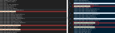

I upgraded the kernel version from 6.1 to 6.6. After that the lvds panel is not working on the imx93 module with a custom board. I always get messaged like
[ 0.137996] imx93-ldb ldb-display-controller: Failed to create device link (0x180) with ldb-phy
[ 0.324387] imx93-ldb ldb-display-controller: Failed to create device link (0x180) with lvds-panel
imx-lcdifv3 4ae30000.lcd-controller: deferred probe timeout, ignoring dependency
imx-lcdifv3: probe of 4ae30000.lcd-controller failed with error -110
I attached the device tree and the /var/log/messages
Can anyone help me with my problem?

You can try to revert these two changes
Use below configs:
CONFIG_DRM_PANEL_LVDS=m
CONFIG_DRM_DISPLAY_CONNECTOR=m
Zhiming

mm_karo
thank you for your reply.
I changed the config, but still the same error.
I attached the current config

mm_karo
I solved the problem.
The media_blk_ctrl could not be used because the CONFIG_IMX9_BLK_CTRL variable was not set. This variable wasn't set because CONFIG_IMX_GPCV2_PM_DOMAINS was not set.
After setting CONFIG_IMX_GPCV2_PM_DOMAINS=y the drivers could successfully be probed.
Thanks for your help.
