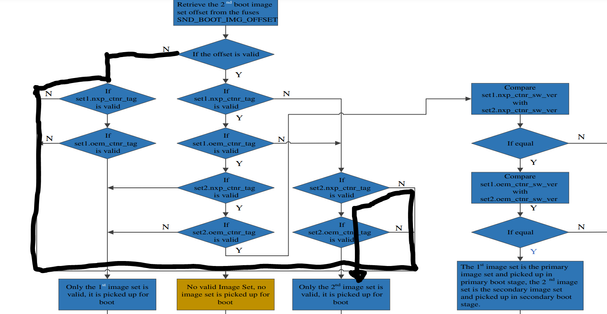

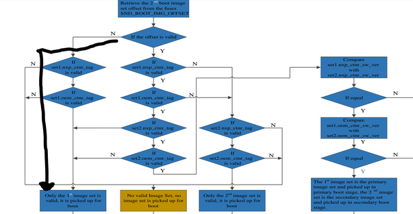

It seems that the Secondary_boot_offset you have is not correct this is why is not taking into account the second container unless the first one is absent, please refer to the figure 18
Scenario 1 & 2
Scenario 3

I believe Scenario 3 should result in "No valid Image Set, no image set is picked up for boot" according to the diagram if the offset is invalid.
But I can try setting the secondary boot offset. What should it be set to when using eMMC boot areas? I think it should be zero, but that is not possible to set?
