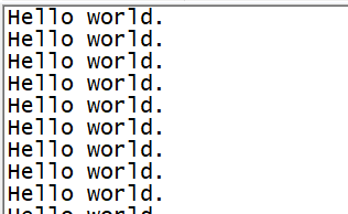

  4. Flash the image to the board, boot it, and observe that both the A core and M33 start normally.
M33 core
After booting, the A core reports the following error and fails to start, but the M33 debug port can still perform normal input and output:

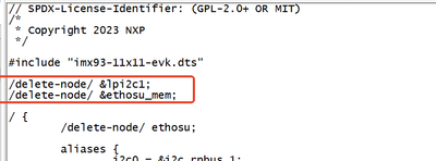

Then, try modifying the device tree to remove rsc_table:
After deleting rsc_table, the A core can start normally, but the M33 core can no longer print “hello world.” What could be the issue?

in the m33 core terminal hello world is printed  but in the A core terminal the kernal is crashing

Thank you very much for your assistance. It is now working very well. However, there is another point I'd like to raise. You mentioned earlier that only with the rpmsg framework can the system boot up from singleboot or uboot. Is it possible to modify it so that the m33 firmware can boot up regardless of whether it has the rpmsg framework or not?
2,691 Views
Zhiming_Liu
The default device tree enable the shared memory and remotproc node for NPU firmware. These resources are for rpmsg framework, so the kernel will hang when initialize these resources as there is no such definitions in M33 firmware if you load firmware from uboot. If you don't need NPU function, you can delete them in dts. But if need NPU, there are only two solutions: 1. Use remoteproc to load elf firmware; 2. Port freertos codes in rpmsg demo.
ethosu_mem: ethosu_region@C0000000 {
			compatible = "shared-dma-pool";
			reusable;
			reg = <0x0 0xC0000000 0x0 0x10000000>;
		vdev0vring0: vdev0vring0@a4000000 {
			reg = <0 0xa4000000 0 0x8000>;
			no-map;
		vdev0vring1: vdev0vring1@a4008000 {
			reg = <0 0xa4008000 0 0x8000>;
			no-map;
		vdev1vring0: vdev1vring0@a4010000 {
			reg = <0 0xa4010000 0 0x8000>;
			no-map;
		vdev1vring1: vdev1vring1@a4018000 {
			reg = <0 0xa4018000 0 0x8000>;
			no-map;
		rsc_table: rsc-table@2021e000 {
			reg = <0 0x2021e000 0 0x1000>;
			no-map;
		vdevbuffer: vdevbuffer@a4020000 {
			reg = <0 0xa4020000 0 0x100000>;
			no-map;
	ethosu {
		compatible = "arm,ethosu";
		fsl,cm33-proc = <&cm33>;
		memory-region = <&ethosu_mem>;
		power-domains = <&mlmix>;
&cm33 {
	mbox-names = "tx", "rx", "rxdb";
	mboxes = <&mu1 0 1>,
		 <&mu1 1 1>,
		 <&mu1 3 1>;
	memory-region = <&vdevbuffer>, <&vdev0vring0>, <&vdev0vring1>,
			<&vdev1vring0>, <&vdev1vring1>, <&rsc_table>;
	fsl,startup-delay-ms = <500>;
	status = "okay";
Zhiming
2,688 Views
Eddy1
Contributor V
Hi:
The default device tree used is “arch/arm64/boot/dts/freescale/imx93-11x11-evk-rpmsg.dts”, in which the NPU has been removed by default.
2,686 Views
Zhiming_Liu
The default dts without modifing fdtfile is arch/arm64/boot/dts/freescale/imx93-11x11-evk.dts
