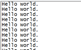

Currently, there are some issues with debugging imx93 single Boot. The test steps are as follows:
  1. Compile MCIMX93-EVK-freertos_hello.zip to generate the BIN file.
  2. Copy the BIN file to imx-boot/iMX9 and rename it to m33_image.bin.
  3. Generate the imx-boot file with the command:
    make SOC=${SOC_NAME} REV=A1 dtbs=myd_lmx9x-11x11.dtb flash_singleboot_m33
  4. Flash the image to the board, boot it, and observe that both the A core and M33 start normally.
M33 core
After booting, the A core reports the following error and fails to start, but the M33 debug port can still perform normal input and output:

Then, try modifying the device tree to remove rsc_table:
After deleting rsc_table, the A core can start normally, but the M33 core can no longer print “hello world.” What could be the issue?

in the m33 core terminal hello world is printed  but in the A core terminal the kernal is crashing

Hi @Eddy1
Are you using default imx93-11x11-evk-rpmsg.dts for kernel?
Best Regards
Zhiming
3,043件の閲覧回数
Eddy1
Contributor V
Yes, the same error occurs with this device tree.
3,027件の閲覧回数
Zhiming_Liu
You are using freertos binary which not support rpmsg framework, which cause this error.
If you need to use rpmsg, please port freertos in rpmsg demo project.

Additionally, it has been tested that when the M33 core is started through U-Boot and then the system is booted, the same error occurs. Currently, after testing, the M33 can only be tested in the file system using the echo command
3,009件の閲覧回数
Zhiming_Liu
Hi @Eddy1
Can you try to load imx93-11x11-evk_m33_TCM_rpmsg_lite_str_echo_rtos.bin from uboot?
Best Regards
Zhiming
2,953件の閲覧回数
Eddy1
Contributor V
Hi:
This demo works the same way in u-boot: after entering the file system, sending a message to M33, M33 cannot print out the message:
u-boot=> fatload mmc 0:1 80000000 imx93-14x14-evk_m33_TCM_rpmsg_lite_str_echo_rtos.bin; cp.b 0x80000000 0x201e0000 ${filesize}

If used in the file system with the command ‘echo imx93-14x14-evk_m33_TCM_rpmsg_lite_str_echo_rtos.elf > /sys/class/remoteproc/remoteproc0/firmware’, it can send and receive data normally.
2,779件の閲覧回数
Zhiming_Liu
Sorry for the late reply,
The solution is that you must use below command before using bootaux.
setenv mmcargs $mmcargs clk-imx93.mcore_booted
saveenv
Zhiming

Thank you very much for your assistance. It is now working very well. However, there is another point I'd like to raise. You mentioned earlier that only with the rpmsg framework can the system boot up from singleboot or uboot. Is it possible to modify it so that the m33 firmware can boot up regardless of whether it has the rpmsg framework or not?
2,746件の閲覧回数
Zhiming_Liu
The default device tree enable the shared memory and remotproc node for NPU firmware. These resources are for rpmsg framework, so the kernel will hang when initialize these resources as there is no such definitions in M33 firmware if you load firmware from uboot. If you don't need NPU function, you can delete them in dts. But if need NPU, there are only two solutions: 1. Use remoteproc to load elf firmware; 2. Port freertos codes in rpmsg demo.
