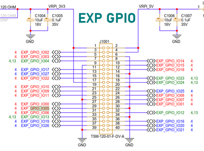

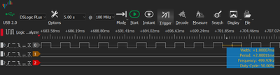

I am able to use the PWM on iMX93 EVK board.
  1. Add the CONFIG_PWM_IMX_TPM to the imx_v8_defconfig file.
  2. Add the configuration to the device tree.
    &tpm4 {
            pinctrl-names = "default";
            pinctrl-0 = <&pinctrl_tpm4>;
            status = "okay";
    pinctrl_tpm4: tpm4grp {
            fsl,pins = <
                MX93_PAD_GPIO_IO05__TPM4_CH0	0x19e //EXP_GPIO_IO05 J1001 29
  3.  When you flash the new Image and device tree to the board:
    $ cd /sys/class/pwm/pwmchip1/
    $ echo 0 >> export
    $ echo echo 2000000 >> pwm0/period
    $ echo echo 1000000 >> pwm0/duty_cycle
    $ echo 1 >> pwm0/enable
  4. You can validate the signal on the pin 27 of the J1001 of the iMX93 EVK boardChavira_0-1729099999966.png
