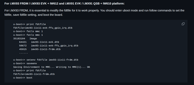

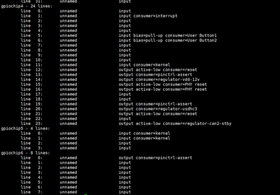

During the process of setting up the OTBR ,i encounttered the following probels.
The command not work.
my GIPO information is follows:
please tell me how the OTBR can working
Doc link: https://github.com/nxp-imx/meta-nxp-connectivity/blob/master/docs/guides/nxp_mpu_matter_demos.md#run...

Hello @stackHome
I hope you are doing very well.
It appears you need to modify the device try:
You can see on device tree imx93-11x11-evk-ffu_gpio_irq.dts are defined the names for some GPIOs to correctly run the examples.

stackHome
 hello,I have done as you instructed, but the situation remains the same.
