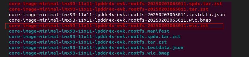

                 I had completed build successfully for imx-93 11x11 EVK referring user guide. No errors during the process. But I'm unable to view the single .WIC file to Flash into SD Card. Multiple files i.e., u-boot, dtb, Image and rootfs are visible individually.
can u guide me is my build process gone wrong and help me with how to get single file to flash into SD card. PFA.

The wic image file was generated successfully.
You can use core-image-miminal-xxx.wic.zst file
You can decompress the wic.zst file with zstd -d xxx.wic.zst command  , and you can get the wic file.
In fact, uuu support wic.zst file format.
write to sd card, you can use
.\uuu.exe -b sd_all   xxx,wic.zst
or
write to emmc
.\uuu.exe -b emmc_all xxx.wic.zst.

                     yes I agree wic file is generated, but the file is  core-image-minimal-rootfs. Wic file. But this  rootfs not entire image part. rootfs need Uboot, Image along with device tree file  Kindly check attached image there no single core-image-minimal.wic full image. which *.WIC file exactly I need to flash into SD.

But unable to get core-image-minimal.wic.zst as a single file in path build/tmp/deploy/images/ to flash into SD CARD. Can you guide me build process to generate single image.

you can also try to build a full image.  using
bitbake imx-image-full
2,575件の閲覧回数
danielchen
Hi @Robbi
The .wic file contains a partitioned image (with U-BOOT, kernel, rootfs, etc), from what I can see, this file is generated in your side successfully.
You can flash this file to your sd card with UUU tool.   Did you  try that?

Thanks got it I'll try to boot.
