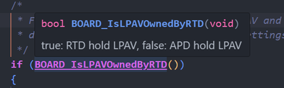

The problem is that, in our suspend case, we suspend the A core (echo mem > /sys/power/state), then the power_mode_switch lpm code lowers the A core voltage etc and then we power off the M core.
If there had not been lpm voltage manipulations I would have tried to just write an ad-hoc driver to driver WUU1 from linux directly, but as things stand I do not think the A core can wake up at all even if an event from WUU1 is raised. We probably need to go through the M core first to raise voltages?

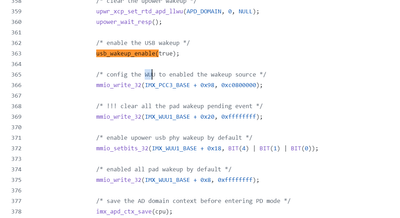

-->Yes, from the APP_WakeupACore function, you need raise the voltage with pmic
I am sorry but I do not see how WUU1 could be used even in a less extreme configuration (e.g. A core asleep, m33 running)
-->The point I'm trying to make is that WUU0 can only be used for M33, wuu1 can only be used for A35, and the wakeup sources they can each accept are fixed in the table.
the m33 NVIC and WIC interrupt sources both list signals for USB0 and GPIOE/GPIOF -- could these be used while the A core is asleep if the m33 core is kept awake?
-->If you just need wake up A core , USB0 and WUU1 can be used, the ATF already enabled these interfaces. These signals have nothing to do with whether the M33 is running or not. But like you mentioned earlier, if you use the M33 power switch demo to control the power switch, you may have issues with it not waking up due to voltage.
https://github.com/nxp-imx/imx-atf/blob/lf-6.6.36-2.1.0/plat/imx/imx8ulp/imx8ulp_psci.c
Zhiming
